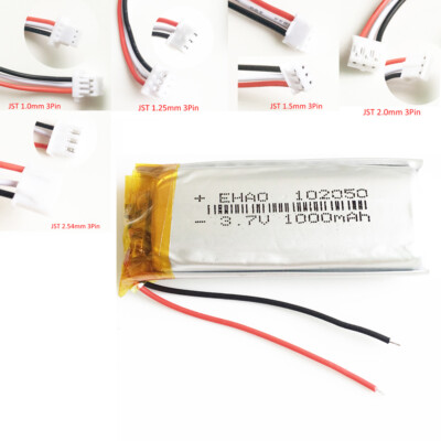

I'm not sure about quality! But, found this on eBay which is similar in power, size and connector (i am assuming it's the JST 3 pin 1mm plug;
Beneath the yellow covering on the battery, is there a manufacturers name?
Thanks, I’ve ordered a couple of those as they look the same, the specs are the same and as far as I know the SC2 is based on the Sena 50. Just hope the size is right at 50x20x10mm.
I think it’s ridiculous that Sena or Schuberth don’t sell them, unless I’ve completely missed something.
The code on your battery '102050' are the dimensions.
Usually they (Sena) won't sell them separately as the battery MFR doesn't sell laminated LiPo out of an OEM design (even for spares). This is true for battery manufacturers such as Murata & Panasonic, and probably for others too.
