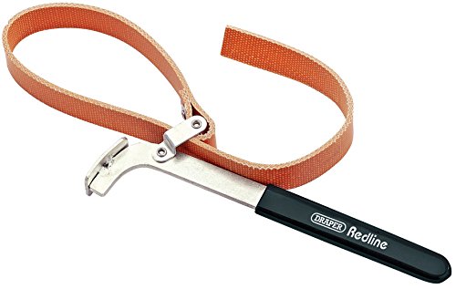

one of these
I actually do have one of those but is just tends to slip, I could put some double sided tape (Just thought about that) around the filter then try again!~ I would rather do that first than attempt drilling holes.
Deffo . Get it as tight as possible and decrease the filter before trying
