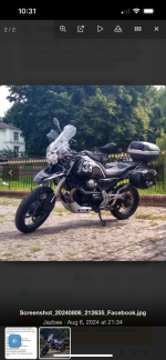

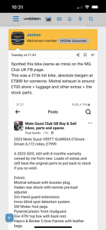

Blimey that is a bargain for someone. But the.45 Peacemaker remains holstered (at least, for now).
Maybe head over to Jazbee’s thread and then Ipswich?!
Blow cobwebs off widowmaker too! 🤣🤣
