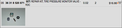

IIRC there is a rubber grommet under the nut. Could be that it's had it? You used to have to buy a whole new unit before but I'm pretty sure you can now buy just a new nut and rubber washer. Might be worth checking with your local dealer as well as the mends suggested above.
