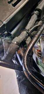

I get that tank off and get a bizarre display of spontaneous sparks out the back of the alternator. Battery disconnected in a hurry!

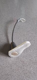

But this was not the end... When I was searching for the fault I discovered something was missing. Specifically a device connected to the new alternator. Something BMW describes as a "voltage protection" cable. On the BMW service CD is called "surge protection diode". Some of you might know it as a Zener diode.

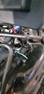

Yesterday I fitted the voltage protection cable. A proper fiddle with the alternator in place. But I now feel a lot better. Jap & German did a neat fix. Really happy with their work 👍🏻

The original breakdown:
The second breakdown (at home!):
The missing link:

and where does this bit fit in the picture
The "surge protection diode"
Most people, including me, aren't even aware of it! But if you fit a new alternator or meddle with it, make sure it's back on there! it's a lottery if nothing happens if it's missing!
