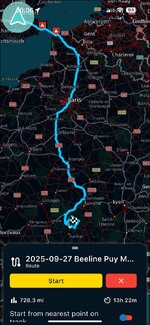

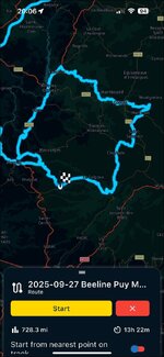

Sitting in the pub, just using my iPhone, I can:
A. Open it straight off the bat in MyRoute’s Navigation app:
I can ‘navigate’ to it from London E1, arriving at the start (which is also the end) and I’m pretty sure it would work:

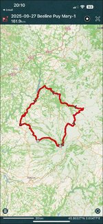

B. I can get it straight into Pocket Earth Pro, where it looks OK:

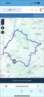

C. I can’t open it as a route in MyRoute Routeplanner, but that is simply because (as Mzokk expected) it contains over 200 shaping points. I can though import it into Routeplanner as as a track. Again this looks fine:

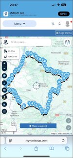

I can then ask MyRoute (again on my phone) to convert the track into a route. This it did very quickly:
D. I can then share it:

When MyRoute converted the Beeline route’s track into a route, it created 80 waypoints (what Garmin calls, shaping points). Transferring in version 1.1 means that the XT displays each as little blue dots. MyRoute recommends a shaping point every three miles, so the route it has created has plenty to meet that ‘best practice’ requirement.
Before I touch Go! the XT offers up the green start point flag, the 78 intermediate points and the chequered flag at the end. The end point has very slightly diffent coordinates, but it’s ostensibly the same place.
When I touch Go!, the XT offers up three choices:
i. The green flag start point 1.
ii. Closest entry point.
iii. The chequered flag end point 80.
It can’t offer up anything else, as it has no other points to aim for. That is fixable if I tap the first blue shaping point and turn it into an orange flag. Doing that now offers four points to aim for, as it adds the orange flag of point 2. Had I been standing at the start point, that is what I would have done. I’d then have selected the orange flag and then hit Go! I do not doubt that the XT would have taken me from where I was standing, to the flag at point 2 and then on, around the route with no problems.
