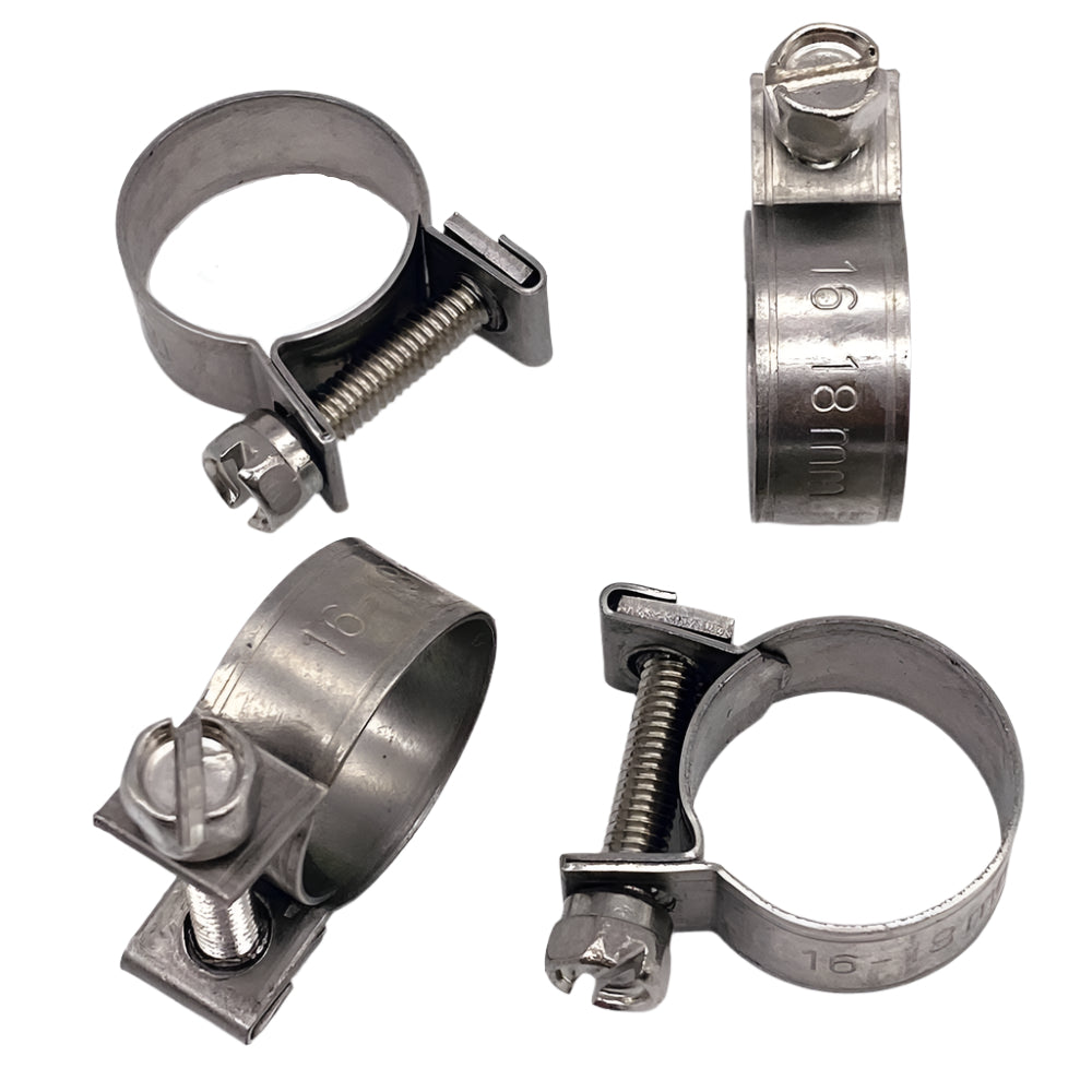

Around a year ago and running lovely !! It looked reasonable quality and straight forward to fit. Only faff was removing the original "O" Hose clamps, I used small jubilee clips on refit, with care, so that the flange resits OK. I think that you need a special pair of pliers to refit new "O Clips"
