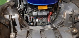

I did remove the front underseat metal bar and fit two small lugs instead that I made on the lathe at work, this was to avoid any risk of short-circuiting the battery terminals, a serious design flaw with the hexhead battery install IMO.
plus one for the motoblatt and the extra terminals make for adding accessories much easier. also seemed to have a lot more cranking power than the varta that was fitted before.
+ 1 for the Motobatt MBYZ16H The MBYZ16HD is the same battery The HD is for Harley Davidson colours ,Black and Orange.
Also +1 for the seat bar modification. I did it to make room for my accessory relays as well as to clear the battery terminals.
