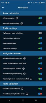

Upturned teardrop (shaping points) are automatically skippable if the option is set in "navigation setting" in the app See Below. The app usually tries to take you back until you go through the next shaping point or if the next one is closer than the last (depending on direction and spacing) Via points "hand Icon" have to be manually skipped. by prodding the skip button on the (android auto or apple carplay) screen.
You can also universally change the default zoom correction on the app. I keep it zoomed out further than standard. And for Android auto I use a lot of tilt as this is not reflected as effectively on an android auto device as it is on a phone.
