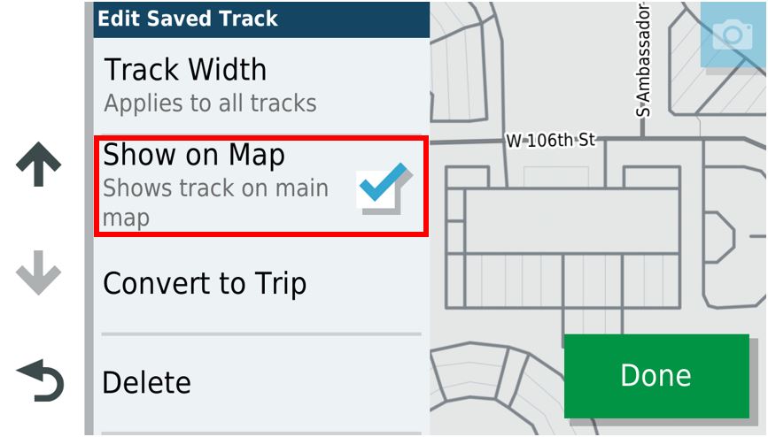

As I'm asking daft questions - here's another one:
When I import routes, I generally import the route and the track. By default, the track is visible on the XT map, even if the route/track is not active. In order to turn off the track display, the only way I can see to do that, is to delete the track. Am I missing something?

Maybe
You can chose the colour of each track and whether to show on map or not by a simple tick in the box

I can see how to change the colour of each track, and how to (globally) change the width of track display, but I cannot see any option "to show on a map or not" - either at individual track level, or globally...
To add to the above, I resorted to RTFM and sure enough, it shows an option to "show on map" at individual track level.
It's a pity that option is not actually on my device...
Reading this thread - Hide track from map - Zumo user forums, the missing option is something to do with "Explore" and all that malarky. I'll need to continue researching. If I ever find a satisfactory solution, I'll post it here - for completeness.
