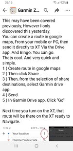

I just made a route on my phone using google maps. Then shared it directly to the XT. Via the Garmin Drive app. It was that simple.
Absolutely fantastic.:thumb
Oh Wow !
I didn't know that. And that is a biggie....:rob

I've posted this in the Facebook Zumo XT group. And it seems that IOS doesnt allow to share from Google maps directly into the Garmin Drive app. Which is a familiar theme with the TFT.
I'll copy the info . One sec.
From my post.

Yes. That's strange. But we know how difficult IOS can make it. On Andriod, simply click the three dots and send to Drive app !
