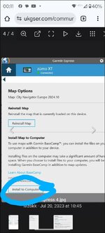

Sorry to be a pain...but why cant I install maps on Basecamp so I dont need to have my Sat Nav plugged in to the computer?
Where it says "Install to Computer" on your post @Mzokk

Hi TT. Garmin have changed the way that Express works under the latest version which is 7.27.1.0. I'm loading maps onto an old Garmin Zumo 390 and will post screenshots of the way to do load maps onto the computer when its already loaded on the unit. When you attach the unit it does give the option to load onto the unit itself, both the unit and the computer or just the computer.
The 396 should have enough internal memory to to hold the whole of Europe as it has 16GB of internal memory and the map version is 8.90GB so you might have an old map version floating about in the unit that needs to be deleted. The other way to increase memory capacity is to put an SD card in the unit and express will divide the Europe map between the unit and the SD card. If you are using an SD card don't install anything larger than 32GB as this will automatically (in windows at least) be formatted as FAT32 so can be read by Garmin devices. SD cards >32GB get formatted as exFAT in Windows machines and can't be read by Garmin devices.
I'll load up the 390 and see what way it handles loading options for the computer after the maps have been loaded to the unit only.
Weird stuff TT. The old Zumo 390 invokes this behaviour in Garmin Express.
Just like in 2023
With the install to computer button
But for my Zumo XT it is different if you go through map details you get to the same screen as you did with the 396 and the install to computer option is gone. This is how you do it on the XT and Maybe on the 396
So the behaviour of Garmin express changes depending on the unit attached. Hopefully the manage maps option with the computer tab will come up with the 396....good old Garmin :D
