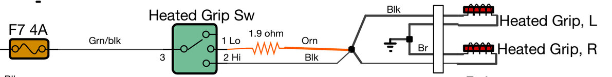

No, but it may help you to locate the bad connection - look around the switch and its associated wiring/plugs, where the resistance wire is connected. If the low setting is making good contact, it's probably giving as much heat as designed, but there may be a high-resistance corroded connector on the main, full-power circuit.
This is the circuit for the heated grips. Which may help in understanding.
