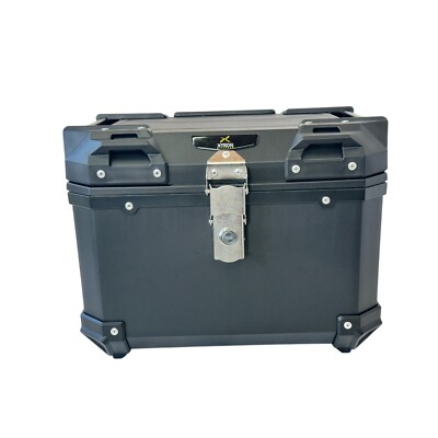

I fitted a black topbox from eBay. It cost £50 new and delivered. Now £61.98. If you watch it. They will send you an offer.
It’s 45lt lined, lockable and has a backrest.
The supplied base plate would not line up without modification to the BMW Carrier.
So I drilled 4 6mm size holes in the base of the topbox, then bolted it directly to the rear carrier with M6 Stainless Cap head bolts. 4 x black M6 x 15mm x 15mm plastic spacers and 8 x 19mm stainless rubber roofing washers. One each side of the Topbox base. These keep it totally waterproof.
Total cost was about £65.
It may be temporary. It may be my permanent fix.
