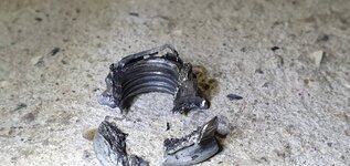

I've come to fit a new steering bearing. Everything has gone well. Except the easiest bloody nut!
The top (left side) stantion nut was stripped. See shots below. I had to get medieval with it. No choice. Nut is off now (I'll re-chamfer the nut recess when the yoke is off).
The bad news is, I think the thread on the stantion rod is the one that's buggered. My thoughts are to run a die over it first and if it is stripped, then use the next die size down. I don't know what's involved in fitting a new rod, let alone the cost.
Anyone been here before? Any tips?

Thread is integral to the stantion ...
Motorworks do an oem used for £60 or a pattern new for £122 but they only do new in 35mm dia
Jesus. I didn't think the whole stantion would have to be replaced
Thanks for the info tho. I'm going to take a closer look in the morning. If it really is the thread on the stantion (I think it is) then it'll be motorworks pronto. And a service for the forks! Can't just do one... Bloody hell.

AFAIK you dont have to replace in pairs its just a tube with a threaded portion on the end
www.realoem.com will give you your correct part
Steptoe & Mikeyboy would be the best persons to ask if youve got to replace as a pair
No need to replace as a pair. And it’s a stanchion .
From pics doesn't look like there was any threadlock on threads of either bolt or nut?
There's none. You're right. But the other, good side doesn't have any either. All dry but clearly torqued, so it's just fine.

Stanchtion from MW ordered (complete with top nut!!!) And new fork oil seals (I'll reuse the dust seals)

Stanchtion from MW was in excellent nick. Now fitted and front wheel back on.
*one tip for fitting the oil seal. I discovered that the plastic tube of an old silicone sealant tube is almost perfect size to knock home the new seal. Worked a treat
Here's the knackered stantion next to the relevant from MW. The book says 40Nm for that nut. Seems a bit high to me, but that's what they are at now.
