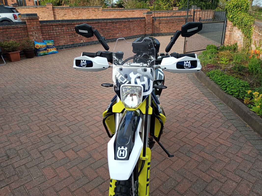

My 701 Enduro I ordered last year is here now (mid Feb actually) done 24 miles on it so far …. I’ve had vertigo for the last month so it’s not been out until last Sunday :blast
I’m looking for ideas and inspiration for the following must have bits ….
Heated grips. Oxford adventure ones
Screw top fuel cap went with a Nomad one
Bar risers. Bike tech +30mm
Wraparound hand guards Husky originals with ally flat bars
Mirror. Doubletakes on there way
Rad/ engine case protection Husky crash bars
Lowering link. Seperate thread to start for this subject
Rear rack +bag ( I do like the Husky bag ) Nomad rack+ Husky bag
Chain oiler system Cobra copy
Tail tidy to get rid of all that massive plastic shite and replace it with less plastic shite and a small plate
Pictures would be good to see :okay R&G equvalent
AXP skid plate
Wotcha done to yours …..?

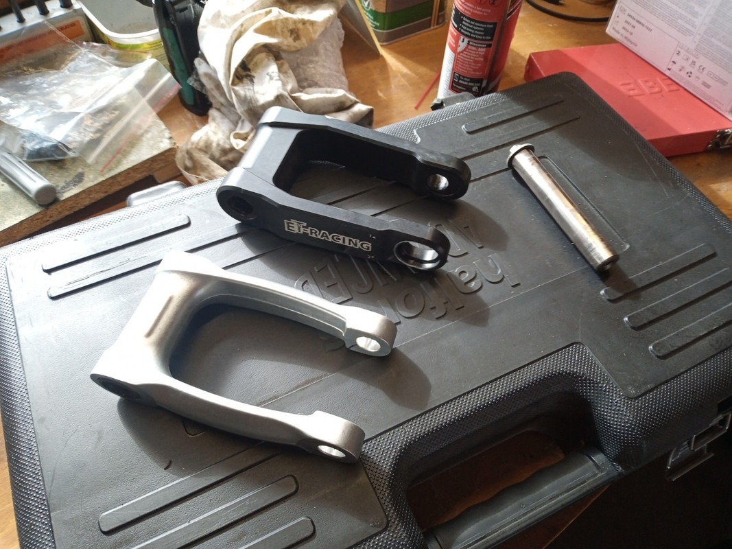

Reference lowering link - mine came with an ET Racing adjustable ht link already fitted. When I got it, it was set up at 20mm lower which I changed to 10mm lower and as of yesterday reverted to standard ht (I am 6'3"!).
So far not really noticed any handling differences between the different hts.
If I get on with the standard HT will get round to removing the ET Racing link and put back on the standard one.

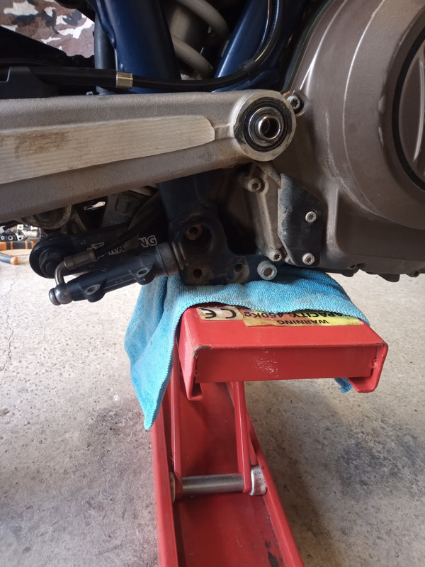

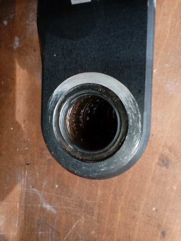

Got round to swapping out the ET Racing suspension link as I wanted to lube up the linkage in any event.
Some what disappointed to find that the needle bearing on the right hand side of the ETR link are knackered - looks like the seal on that side is damaged/torn. Lucky I have the original Link to put back in :augie
Any one got a good source for new bearings?
Paul
Try Trent Valley Bearing in Nottingham. They stock most types and you could just pop in with the old cage and they will sort.

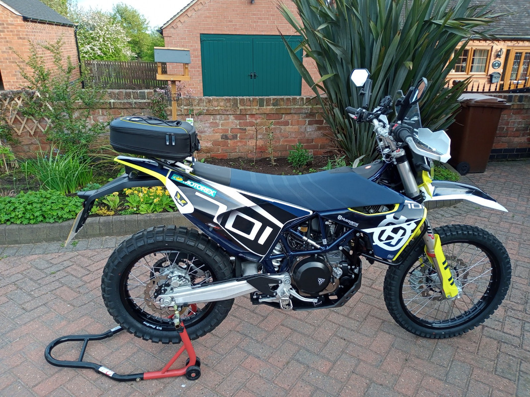

Like the 701 so much that decided to buy a brand new one which could well be a candidate for "the last bike I buy before I die" :augie
nice one Paul.
must admit I was toying with the idea of doing the same on my 2021 690, although it wouldn't get me much more than a tweaked colour change and a fresh warranty, was px north of 7k? the new bikes are what nearly 10k now should drag used prices up a bit you would expect.

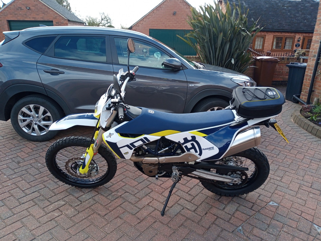

Just finished adding the LR tank to my 2022 model. :thumb2

Think I'll hang onto my *old* 2019 bike. I have no wish to get tied up in that warranty/dealer servicing malarky again.

Sensible thing would have been to have kept the 2021 one but just fancied one which I have owned from day one and then keep it long term :)
Yes, the fact that I've owned it from new definitely makes a difference :)

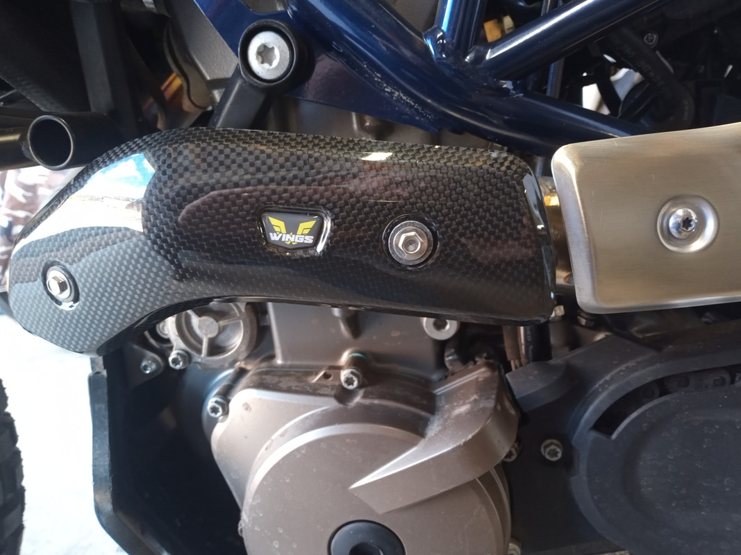

I have a couple of holed trews myself, but somehow have never got around to fitting a cover.
I seem to recall i was going to make one once.

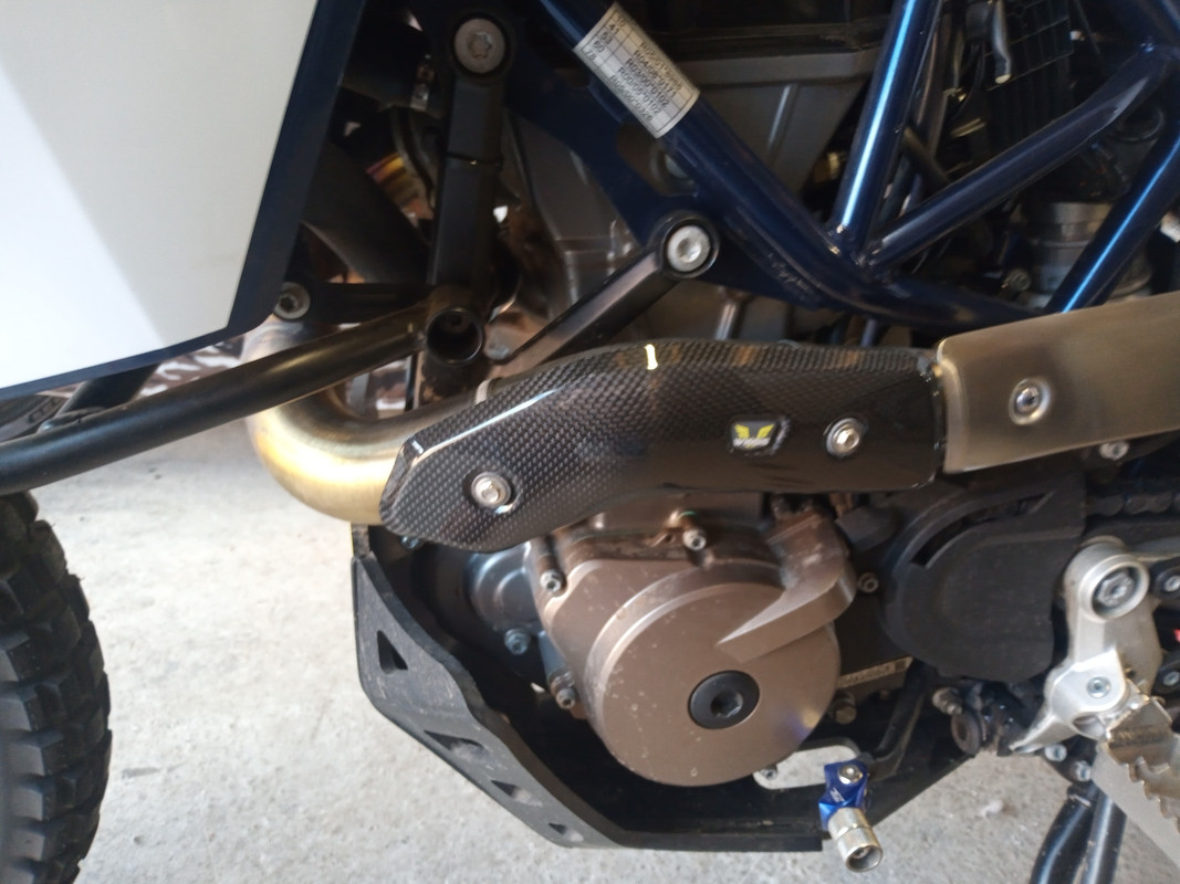

Had a play with trying to get a cheap ebay sourced heat shield to fit but gave up when it started to melt all over the exhaust :blast
The Wings one as expected fits really well and goes over the original rails so they do not need to be hacksawed off- on the expensive side as Wings charge 26 euros postage but did not get charged VAT so ended up costing me £69 in total.
