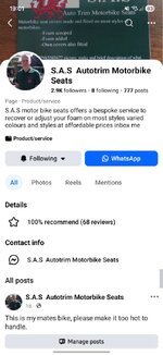

Build time....
Try S.A.S
I've not used them myself yet but they were recommended by someone who's opinion I'd trust.
