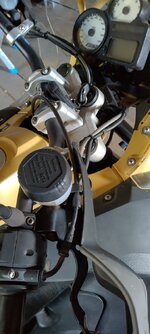

Re your throttle cable. The exut from the twistgrip should be above the brake master cylinder, yours apoears to out by 180°, running below the master cylinder.

Out by 180 degrees?! Holy cow. That would do it. Thanks 🙈
