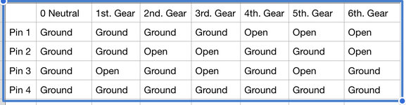

As you’re diving under the tank again to the RID connector, you could try this.
Gear selector switch test from RID Connector.
No power required from the bike as tests are for earth switching. Disconnect the main wiring harness connector at the RID connector and test for continuity at the following pins.
Set up multimeter in Ohms and connect one lead to a good earth the other lead goes to the pins in turn. Eg. With bike in Neutral all 4 pins should read short circuit.
In 1st gear pins 1,2 and 4 should read short circuit only pin 3 should reading Open circuit.
You will notice that Pin 4 is a constant ground from the gearbox, so you only really need to test pins 1,2 and 3
It might help you with your fault diagnosis.
Thanks Ian. Thats really helpful. Since I only have a 2nd 3rd and 6th gear indication it looks like pin 2 will be open on neutral 1st 4th and 5th. I'll get a look at it this afternoon with the multi-meter. Again many thanks.
