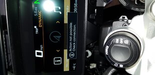

Hi,Paired my sena headset up with my garmin but cant pair with the tft.Can i only pair with one ? if so which should i pair with to listen.
Thanks
I pair mine with the TFT, it passes instructions from the Nav 6 through fine without my comms paired to the Nav 6.
Cheers,I will unpair with the Garmin and pair through the TFT and give it a go
Do you have to be on the Nav section of the TFT to get the instructions or do you have to flick the menu switch on the LH switch gear to nav from TFT or anything similar. When I tried I didn't get any nav6 turn by turn.
Cheers
G
Everything is paired up but i am getting this message coming up.Any ideas please ?
whatever i do it wont work.Followed the instructions.I can pair phone and helmet with tft then cant pair helmet with sat nav.Its probably me but i cant figure it out.I would like to get it working properly.
Do I understand this correctly?
-- You pair The phone to Sena
-- You pair GPS to Sena
-- Then, TFT is not able to pair?
Are three pairings possible to the Sena?
The common way is to Pair the phone with the GPS and operate the phone through the GPS. And then Pair the GPS to Sena and TFT to Sena. Or am I totally wrong here?
The way it works for me:
1. undo all pairings: TFT, phone, nav, helmet. Then turn off all devices.
2. Turn on bike/TFT and BT on phone (helmet off and Nav off); pair phone to TFT, once done, turn off phone BT
3. Turn on helmet (only TFT and helmet are on) and pair with TFT; once done, turn off bike/TFT
4. Turn on Navigator and make visible for BT, helmet is still on (bike TFT and phone are off). Make helmet visible and search with Nav for new devices > pair with helmet.
You should be good to go.
Hopefully i have now done it:beerjug:
